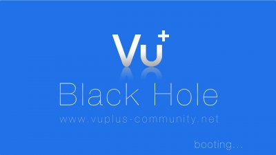

Black Hole 2.0.9​
What is new ?​
  • New bootlogo by mikark

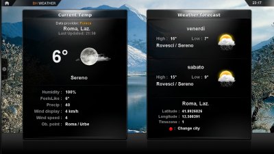

  • Black Hole weather: switch to msn provider to fix bug when town not found and implement auto-langauge.

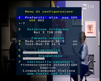

  • Teletext: Update to the latest tuxtxt version (this fix rai hd televideo too)

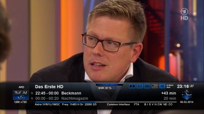

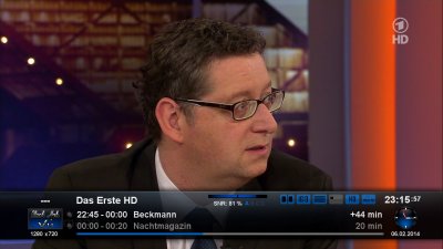

Infobar / OSD
Analog Clock Gui
Channel orbital location
Signal SNR, BER
Infobar picons

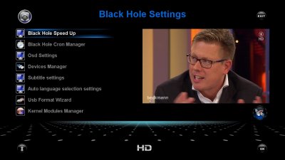

Blue Panel
Extra Settings
Black Hole Speed Up
Devices Manager
Usb Format Wizard
Telnet Panel ( Telnet Panel)
