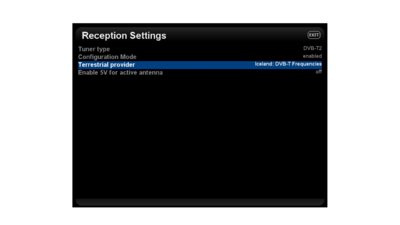

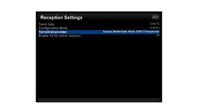

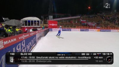

Go to MENU - Setup - Service Searching - Tuner Configuration
select DVB-T2 tuner
in Terrestrial provider set right settings...

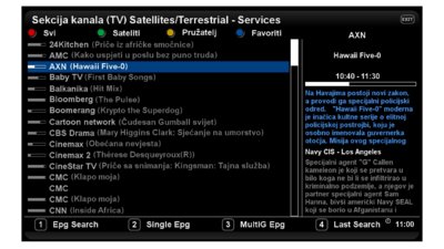

here in attachment is screenshots... also EPG screenshot added with local DVB-T2 provider EvoTV in my country...
cant say for DVB-T2 channels but EPG on HD channels from DVB-T work
unfortunately only have SD DVB-T2 channels for test....
Its dvb-t2 hd channels that can't display epg correctly sd channels are fine but works in other image fine with same settings.

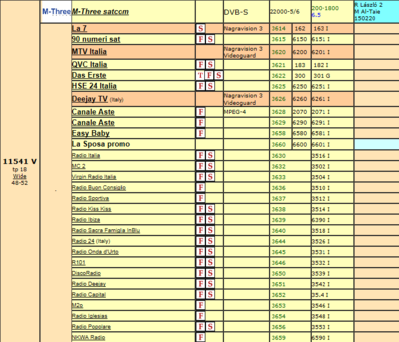

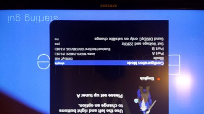

I have installed it on my vu plus duo2 but unable to find any channels. I have two dish input into one line. Other images which I am not allowed to mention find all the channels easily but blackhole can find only about ten channels.
This can't be an image issue, check your tuner settings.
Hi Kazo
You are getting this transponder from Hotbird 13º 11541 V 22000 5/6

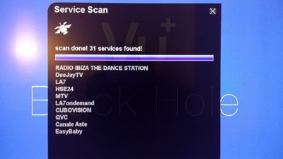

Make a Full satellite search, instead of searching one only transponder!

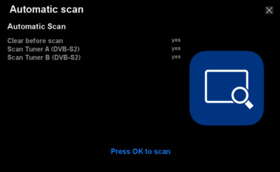

Thanks nunigaia but how do I do that?
On your remote control:
Press <MENU>
on Setup press <OK>
On Service Searching press <OK>
On Automatic Scan you get this Screen:
If you have got a screen like this ---> press <OK>
Best regards
