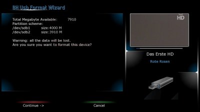

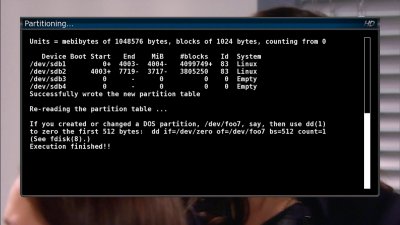

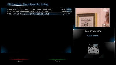

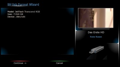

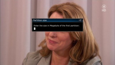

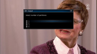

I have an external HDD 500G and wish to utilise only the rear USB port. Can I partition the HDD in 3, as media/USB, /universe and media/HDD? Or I have to do the media/USB and /universe on seperate USB and let the 500G HDD just for recording thus using also the front USB port.
and map these partitions as you like.I have intsalled this Version On my box and all looks good, the only problem I have found is that after selecting restart from the menu
