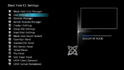

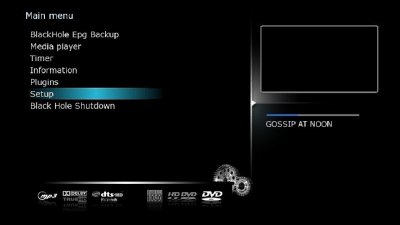

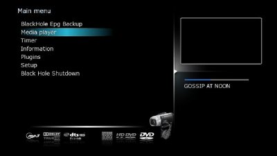

I changed the *.png files as Plusforce wrote before but i found a small ''bug'' on the layout images...Everything else are doing fine!!!
As you can see from the previous screenshots i took, the small icons of the menu's is a bit left than the default point...that means that it is not shown well and other icons are above them, hiding them...
Does anybody know how we can increase or decrease the grid poster height or width and place the icons in their default location in the panel?
Thanks in advance...
I think it is a job for those who really knows programming Linux.... ;)
