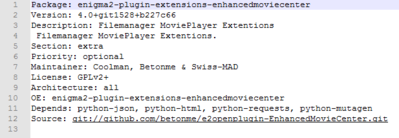

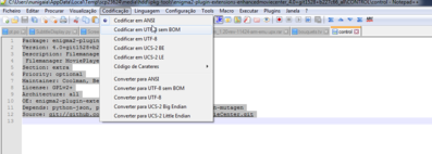

hello nunigaia. i get this "ipkg-build: Error: Package name contains illegal characters, (other than [a-z0-9.+-])" whats wrong with cotrol file
The problem, i think, you are editing the file with the internal FTP editor.
You must edit it not with the internal FTP editor, but with for example:
  • notepad ++
  • geany
After the last line, you must have allways a blank entry line: ( see example ... line 13 ... is the last one of the <control> file and is blank
You may also use as codification "ansi":
control
postrm
postint
conffiles
control -- attributes 644
all the others -- 755
The folder <CONTROL> ... allways uppercase letters and attributes 755.
