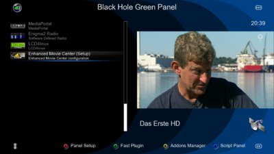

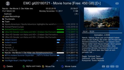

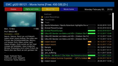

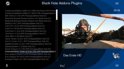

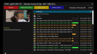

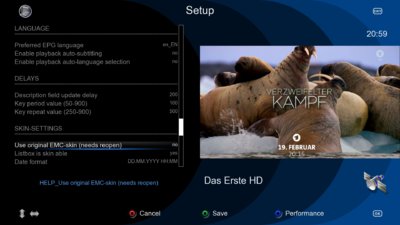

Is enabled
You do not have to do anything if the plugin is installed.
Just press the video button.
And if the plugin is not installed then is the problem of the other nature.
I can not test it.
I have here only Ultimo 4K , Uno4K SE ,Zero4K for testings.
Maybe someone else can test it I think you said you had a solo/2 receiver
