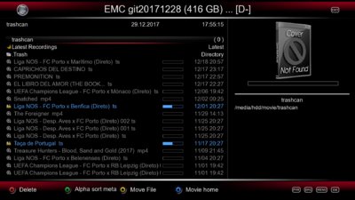

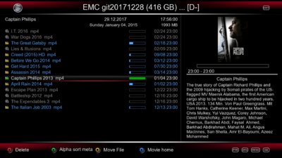

@Seth_72
Can you please test this version ...
Note that all development until now is updated ( lastest version - Git1439 from 28/12/2017 ).
Please, report your tests ;)

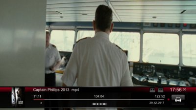

Thanks Nunigaia but it wont start al all., i notist that the jumpin picture is when i watch mkv mp4 but ts works in bh 303 thats every thing works so back to that version for now

Retry with this one ( new version ) Git1443 28/12/2017.
Thanks nunigaia now its works. I downloaded it again perhaps bad file at first. Question ihave why mkv movies are unstable in the begining of the movie even in vuplus basic player. And do you know why the subtiles dont stay selected. Have to select everytime i see a movie and on an old emc 3.74 its keeps selected subtitles..

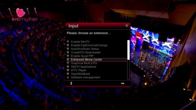

Remember that, if you make a clean install, you must set first EMC from scratch, ie., you can´t push after installing the <video> button to start EMC. ;)
