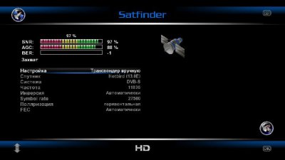

Thank you very much. The tuner found:
And more:
This is the tuner B:
Manual scan:
But other problems arose:
Does not find services. What's the problem?

I'm very happy to see your tuner is been detected now.
I'm very curious: could you please reboot your box and post here the "dmesg" output?
I would like to verify if the device needs some additional firmware and verify if it's correct the place where I've putted the patch.
Seems all correct.
Could you please test your device with an already set of settings ?
I admit: I haven't tried the scan function but I've used my TeVii S660 (we share the same driver :) ) with a prebuilt set of settings (for motorized dish in my case).
Antenna tuned to Sirius 4/Astra 1E (4.8)
Antenna is also configured to Sirius 4/Astra 1E (4.8)
Antenna is not turned.
And so on all satellites and frequencies - the signal is the same.
