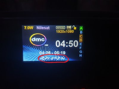

Hello
any one please help me to fix the Arabic language of the program text (letters are separated and reversed from right to left)
