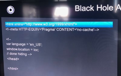

@Matrix10 When I try either method, it doesn't work for me:
When trying to download from server I get what looks like an XML file displayed
I can connect to the server but the installation fails

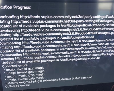

The screenshot I provided shows that the internet connection is not the problem - it downloads the four gz files but then gives an error for each of them
* unzip: invalid gzip magic
Does anyone with knowledge of what linux is trying to tell me have any idea what this error means? Searching the web returns suggestion varying from the gz file being compressed in some strange way, to the file being corrupted
I can happily download the gz file to my laptop and unzip it so it doesn't look like the file is corrupted.

I really do not know which file you download and how you get it .
But for sure not file i have write to download from BH server.
On our server is the LCD4Linux ipk file and not the gzip file.
And not version 4.8 but version 5.0-r4
The only configuration for LCD4Linux is a tgz file and only one file
for UNO4K SE on Black Hole image server.
And www.w3... not exist on our server
You do not use the original image
or you plugged in a plugin that download plugins from another server but not the Black Hole server.
and you download from Black Hole server dozens of packages that are not needed for LCD4Linux.
Or you tried a manual installation of an old version.
My advice is to install Black Hole image again,and LCD4Linux and config from Black Hole image server As I wrote it already.
