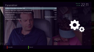

where is the best place to store picons, I have always used usb
but every time I update my image, I have to format the my usb stick and re install
should I install picon to hdd
thanks
OK. Thank you, I was told that storing on your HDD can cause heating problems because the HDD has to working everytime I turn the channel over
Sent from my Nexus 7 using Tapatalk
Don't problem works like the way Meoboot, I'm used by more than five years without a problem,Do not forget to run the fan control.
