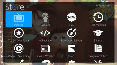

when i download MyMetrix it says App installed but i can't find it anywhere? and i can download again and again but it dosen't say it's already installed? i have VU+ Duo with Blackhole 2.0.8 and i made a 256mb swap file
i've checked every menu, there is no MyMetrix anywhere?
as first you have to build your skin.
Go to green button -->MyMetrix -> Settings -> select "MyMetrix BlackHole by @capa" as template and save your Skin, after Skin is ready you can select it in Skin Options

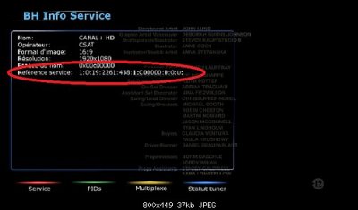

i downloaded this xpicon pack, but it's only working on some channels and the right Picon exists... can i update the filename some how so it will work??
just renamed picons does not work with the right reference service that you can find in menu info
