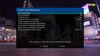

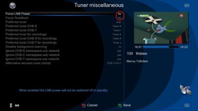

Go into menu - tuner - tuner miscellaneous.
There should be some settings in there called force lnb power and force tone burst, these were originally both set to off by default, but this setting caused a bug with some channels when recording, so the decision was made to enable them both as it fixed the small bug and nobody found any issue's in testing.
So you can try disabling these 2 options again, and see if it solves your problem.
Me too, but without changing to NO the two options, I had no signal from the LNBs managed by the DiSEQc protocol, only by the SCR LNB. Now everything's OK.
