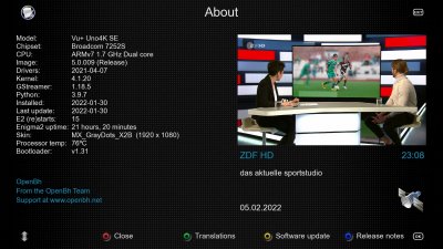

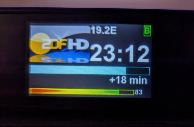

I just fresh flash OBh image few hours ago, and yes LCD4Linux working with no issue.
Already solved in Duo 4K: I uninstalled the LCD4Linux and returned to install. It should be the solution to UNO 4KSE.
