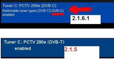

My 290e don't work in 2161 se picture
Can't see anything about this in changelog ???
((As a matter of facts none of my DVB-T2 dongles works in 2161
Not 290e nor 292e neither Astrometa chinese dongle,
Only my oldest one works Intuix s-800))
((And I also have trouble with CI+ slot))
((So atm i have to choose between VTI or BH215 with some other disadvantage if I want HD))tunerC.JPG

I was struggling to.
But i finally managed to change the setup from "DVB-C" to "DVB-T2", and I can watch dvb-t tv again
(Greenscreens ...)
However my second 290e is still not recognized ... ???
