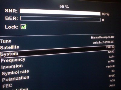

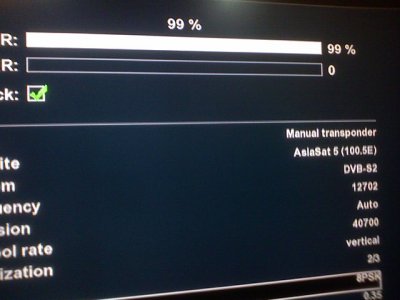

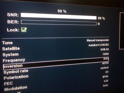

Vu+ UNO Firmware Upgrade
HI
ASIASAT-5(100.5E)
VU+UNO
FPGA 4.4
SIGNAL IS VERY GOOD
BUT VU+UNO CAN NOT Search any channels (MANUAL SCAN )
IT HAS PROBLEM WITH FREQUENCIES
12702 V
DVB-S2/8PSK
40700 2/3
12642 V
DVB-S2/8PSK
40700 2/3
12582 V
DVB-S2/8PSK
40700 2/3
This problem is also seen in other images (VTI-.......)
#132
http://www.vuplus-community.net/board/threads/vu-uno-firmware-upgrade.2955/page-7
BEST REGARD

For sure, look at my post about low SR frequencies problems !
hi
thanks
YOU SAY
WITH NEW FPGA 4.4=PROBLEM!!??
WITH OLD FPGA 4.2=NO PROBLEM !!!
Really strange :)
