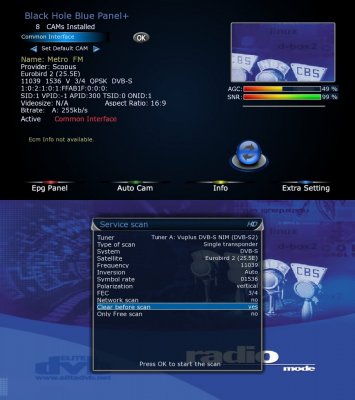

On 25.5E for these radiochannels (11039 V) I have SNR 99%
and NO audio dropouts with Vu+UNO and BlackHole-1.6.6, yesterday I was on Metro_FM ~ 60 minutes.
But ... I when I started to test, I had no signal with sometimes earlier automatic scanned and saved channels, where SR was 1534 ,
then I rescanned this frequency manually with SR 1536 and activated "clear before scan" option.
Can't get here in my location this Turksat HD channels Freq. , as it's on "east beam", no signal here with 1.8m primefocus dish, "europe beam" is ok.
It was tested on older BH-1.6.6 (drivers 22.11.2011) ,
owners of motorized dish can test these radiochannels on latest BH1.7.2.
