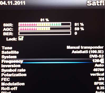

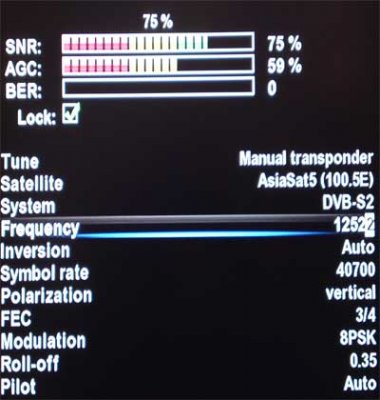

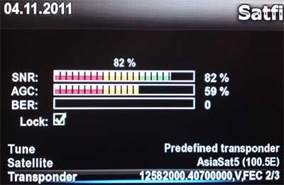

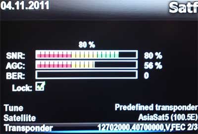

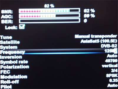

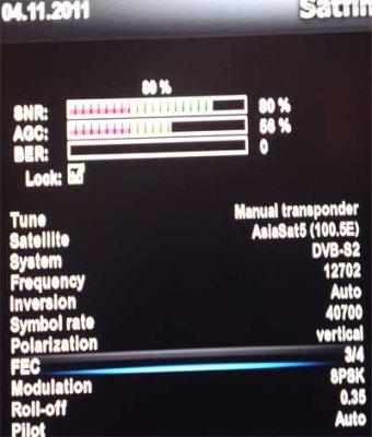

Dear BH team,

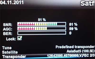

I checked some frequencies like AsiaSat5- 100.5 E. UNO shows the efficient signal strength and quality, but DOES NOT scan the channels.
I upgrade into FPGA 4.4 and latest drivers last night. Also, I test it with BH 1.6.6.
In many frequencies and in many satellites, you can detect the above problem. e.g. in 11881 or 11900 in BADR satellite (26.0E)
As I tested in Asiasat 100.5E, many channels have very good signal strength & quality, but UNO cannot scan them.
I send some pictures for these frequencies in 2 modes:
1- Satellite finder
2- Manual Scan
Sample frequencies in the pictures are:
12582/40700/V , 12522/40700/V , 12702/40700/V , 12642/40700/V
All above frequencies are DVB-S2- 8psk
more info about asiasat5: http://ir55.flysat.com/asiasat5.php
Finally I attached a movie file, I try to scan one of the mentioned frequencies, but NO channel would be found.
Your kind and prompt consideration will be highly appreciated.
Thanks for your great efforts
