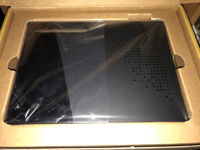

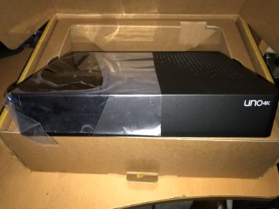

I am testing a pre-production model here, therefore the box that mine arrived in will be different from the final retail models.

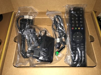

On opening the box up, you find the following inside:
  • Vu+ Uno4K Satellite Receiver
  • Remote Control (the same popular Universal type that is supplied with other models in the Vu+ range)
  • 2x AAA Battery’s
  • High Speed HDMI cable
  • IR Sensor
  • Power Supply unit
  • Mains Power cable

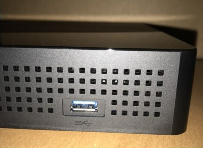

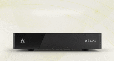

The Uno4K is a small box (the dimensions are (W x D x H): 230 mm x 175 mm x 50 mm). The front panel is basic with only a white Led glowing on the left, there is a USB 3.0 connection on the left hand side. The box is finished with a matt black on ¾ of the lid, and the other ¼ has a shiny glossy finish, which looks great (although the glossy part is a fingerprint and dust magnet).

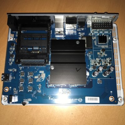

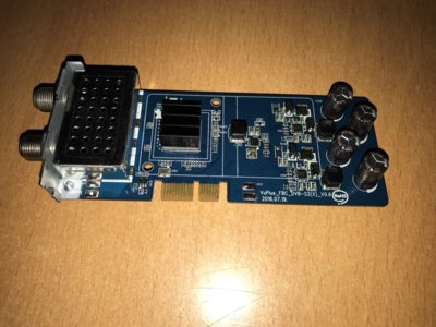

Looking inside the Uno4K,, at the rear right, is the advanced pluggable FBC tuner, (this will work with the dual FBC DVB-S/S2 tuner or the dual FBC DVB-C tuners). The large black heatsink you can see in the centre covers the Broadcom BCM 7252s 1.7 GHz dual core 12,000 DMIPS ARM v7 cpu,, then at the rear left is the the card reader and CI slot. There is no space for any internal hdd in the Uno4K.

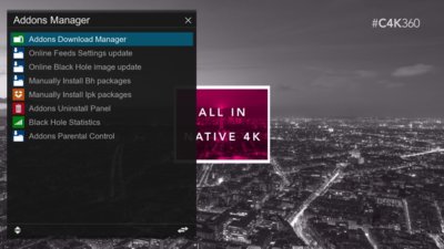

Before I did anything else, I let the receiver boot up, to make sure it was all working ok. Once booted and I was happy, I then proceeded to shut down the Uno4K, pulled out my favourite usb stick, and loaded on the Black Hole 3.0.3 image for the Vu+ Uno4K J
If this is your first Vu+ receiver, you will be pleased to know, that installing an image onto any of the Vu+ receivers is a very simple process. Simply grab a usb stick, format it in fat32 with your pc, download the BlackHole image from www.vuplus-commuinity.net (other images are available from different teams) and extract the zip file contents to the root of your newly formatted usb stick. Once this is done, plug the usb stick into the usb 3.0 port at the side and then power the box on at the rear, the front panel led will start to flash in a slow (almost like it’s breathing) sequence, and when finished, it will flash a fast on and off sequence.
At this point you can remove the usb stick and power the box off and back on again.
It is a very quick and simple process and it doesn’t take long to reflash this box.

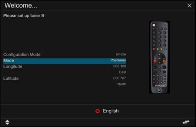

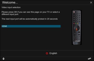

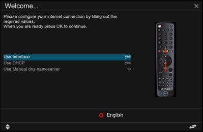

On first boot after flashing, you will be greeted with the setup wizard, just follow the simple onscreen instructions to setup your new Uno4K.

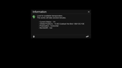

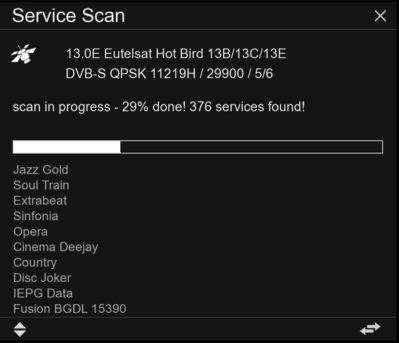

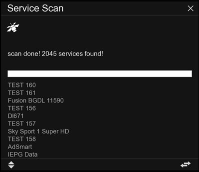

So first of all I decided to do a channel scan, which didn’t take very long at all, I scanned over 2000 services on 13°E in under 10 minutes.

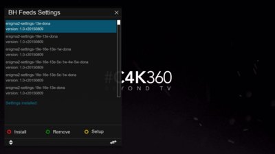

If you would rather not wait, you can grab a channel list from the BH addons server, or choose one of the many available on the internet.

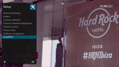

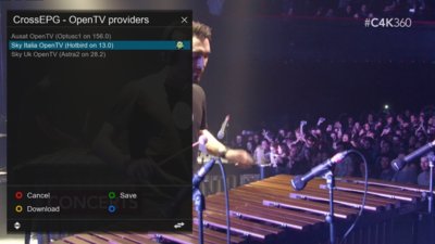

With the channel scan done, I then added the EPG, I personally used CrossEPG

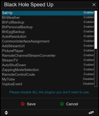

The Uno4K from a cold boot gives me a picture on my screen less than 38 seconds (time will vary depending on how many plugins, skins, plugins etc. are installed) and an enigma2 restart takes only 15 seconds.

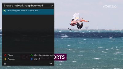

As already said there is no room for an internal hdd in the Uno4K, however you can use a network hdd if you have a NAS setup (or another Vu+ box that does have a hdd installed), using the Network & Mount points feature in most images.

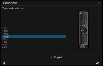

The Uno4K will output tv pictures at many different resolutions, so you do not need to have an Ultra HD tv to use this receiver, in-fact viewing 4K UHD channels on a 1080p tv makes you wonder if you even need a 4K tv as the picture is bright and clear even when downscaled. However if you do have a 4K tv then you can set the Uno4K to output at 2160p and this will do all the upscaling for you, obviously SD content does not look as good as HD and UHD, but it doesn’t do a bad job of the upscaling (probably a lot better than some of the cheaper 4K tv’s can manage on their own). On my tv, compared to the Solo4K, the Uno4K actually gives a sharper and clearer, more defined picture and if you have some HDR content on your NAS it will also play that back too.

The Uno4K comes with swappable tuners, FBC stands for Full Band Capture. This new FBC tuner, will allow you to tune into 4 different frequencies per tuner, which means that you effectively have 8 tuners inside your Uno4K and as it is a removable tuners, you can have either DVB-S2 or DVB-C.
To get the maximum from the DVB-S2 FBC tuners you will need to use a Unicable LNB, this means you can choose to view / record 4 different frequencies per tuner, however using a conventional lnb as found on most current satellite dishes around the world, it is still possible to tune to 8 different tv channels, but there are some limitations to which frequency’s you can tune at the same time.

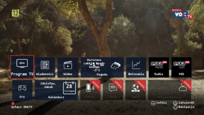

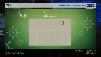

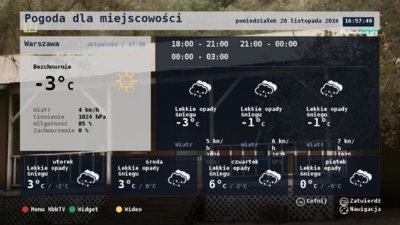

The Uno4K also supports HbbTV, just tune to a channel that provides the service (Vox Music on Hotbird 13°E for example) and press the red button, the Uno4K will then use your internet connection to connect to Vox Music’s on-demand services.

Another great feature of the Uno4K, is the Blindscan function, this is more for enthusiasts and advanced users that like to scan the skies for all the channels they can find. The Blindscan plugin will ask you to select which satellite you want to Blindscan, and then the receiver will do the rest. It’s a great feature especially when looking for feeds, or scanning those satellites where channels move around frequently (this feature requires a driver update to get it working at time of writing this review).
