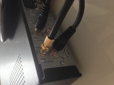

How much cables do you have connected to your tuners? How they are configured?

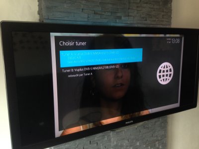

Hello,
I confirm the problem. On my two VU + DUO2 I can not record and watch another channel at the same time with the "loop trough".
With BH 2.1.0, there is no problem
Hello,
Again, we need to know how much cables you have connected, how your tuenrs are setted up and what kind of dish system you have. Without these infos, your report is not useful.
