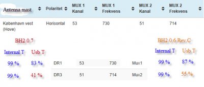

PCTV systems nanostick T2 290e
Blackhole 2.0.7 ( VU+ Ultimo )
Some channels is having very poor signal strength (Usb tuner only, Internal Tuner ok (99%))
Danish DR3 (Mux2) has never been supergood (55% unstable) but in BH2.0.7 it is unwashable (Black screen %41) (Internal Tuner ok (99%))
Danish DR1 (Mux1) is good and has always been good (87% stable) and in BH2.0.7 still good 83% (Internal Tuner ok (99%))
